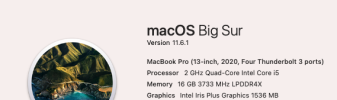

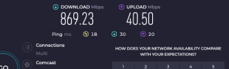

My home church is also small and our issues in 2020 with Drop Frames was due to internet speed and jitters/lags. We are using a Macbook Pro 2020 Intel Core i5 (currently still running Big Sur). Previously we were on Comcast broadband with 100gb download and only 20 Upload - This was causing a lot of drop frames and video issue with the live stream. We tried to work around this by using mobile hotspot (11gb upload speed) and it was the same drop frame and video issues but surprising some days the hotspot was more stable (less jitters/lags). We had to upgrade our Internet, but because of Comcast limitations the most we could get was 40gb upload speed (see the image below).
1, Check your UPLOAD internet speed, you need at least 40gb UPLOAD speed for 30 fps.
2. Make sure your using Ethernet cable to the computer NOT Wifi - DON'T USE WIFI for Stream as you won't get the Upload speeds you need (therefore will experience drop frames and bad video quality).
3. Check your internet for jitters/lags: https://www.fusionconnect.com/speed-test-plus/ping-jitter-test
4. Make sure you close windows and web browser apps on your Macbook that you don't need to use for live stream as this will affect your CPU usage. We only have Restream.io and OBS Studio open. We use the Bible Plugin for OBS.
2. My church is using a security CCTV camera (I know this is very bad quality) for now until we can get budget to upgrade to Birddog 4K PTZ camera. I hope to get our camera upgraded in 2025. Here are my specs (see pictures attached).
