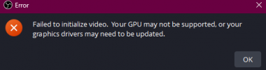

*ATTACHED OBS LOGS* Failed to initialize video. GPU not supported, graphics drivers need to be updated.
solarbugs

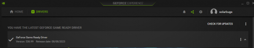

I have a NVDIA GeForce GTX 1650, running Direct X at 12. Whenever I have tried to open OBS it keeps showing me this error. I have updated my drivers, to no success, they are the most up to date they can be. I have tried uninstalling and reinstalling OBS, again no success. I have no idea what to do as nothing is helping anywhere and I don't know what else to do at this stage. Attached the most recent log.

According to your log, you configured a base resolution of 20853x3057 in OBS. This seems too big a frame buffer, so OBS cannot start. To start fresh with OBS, delete the folder %appdata%\obs-studio. This removes all OBS config and you're able to start fresh.
solarbugs
This has worked. Thank you so much!
