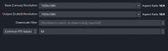

Hi there. A while back, we started experiencing tech issues with our livestream to YouTube. We use Castr to stream our feed and the issues came shortly after an update of OBS (beginning of the year). We are trying to do a process of elimination as to why our streaming quality is now suffering. Our tech and equipment has not changed. We are using the same settings we had been using on our panasonic gh5 cameras (HD, 60 FPS). We have tried many different settings combinations in OBS, including the settings Castr has suggested, with no luck in fixing our issue. When we stream to YouTube, even when we tried 4k resolution, there is bad pixelation on our host when he moves around. Only until a day after when the youtube video has processed does the quality improve. But we are frustrated because the stream quality has been better in the past. This pixelation issue also occurs on our recordings. Is this something anyone could help us fix? Please see screenshots of the settings we use in OBS below.
