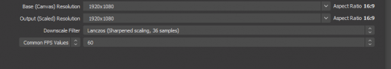

Since monday I have the issue that OBS doesn't let me stream on 900/1080p and I also can only select 720p as highest resolution on my twitch stream. First I thought it was because of the new update so I downgraded from Version 28.0.01 to Version 27.2.4 but my stream's highest resolution was still 720p. When I use StreamLabs OBS (Yeah, I know its trash) with the same settings as in OBS Studio it works and I can watch my stream in 1080p. Can someone help me on this issue?

Twitch removes source video rate if you go beyond 8500kbit (video+audio bitrate). Set 8350 max for video and 128kbit for audio bitrates to resolve the issue.

my bitrate normally stays at 6000 but i will drop sometimes to the lowest 5400. so as a test i put it too 5000 and it went to 720p.so i put it back to 6000 and its 1080p but blurry at high compressions points. also i don't know what you mean by control is doing nothing what is control.
