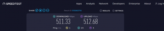

First of all, I'd like to say that I took a look at the section about "Dropped Frames And General Connection Issues", tried everything there and nothing worked.
I have been having this problem with dropped frames and it happens randomly, sometimes a couple of minutes after start streaming, sometimes takes like one or two hours, but it always occur -- the game I'm playing doesn't matter.

I'm playing at 4k (with freesync on) and doesn't matter if I try to stream at 4k, 1440p, 1080p, 60fps or whatever combination with different bitrates (15k, 13k, 12k, 10k, 9k, 8k, 6k), that problem always happen. Also tried in different platforms, using different codecs.
Since I'm playing online games and I don't see any problem with latency on game (neither from my perception nor from the game itself numbers) I don't think it could be internet. I'm also using Discord and no voice problem in or out, no disconnects, nothing.

Downstream traffic is different from upstream. Most of what we all do (and notice) is download, so ISPs focus on that. Download can be fine and upload NOT be.. Or it could be your ISP to your stream platform of choice. Have you tried streaming to a different platform?
If you tried 'everything', that means you connected your PC to another ISP. What happened then?
06:59:20.425: Output 'adv_stream': Number of dropped frames due to insufficient bandwidth/connection stalls: 6557 (32.4%)
What are you doing for real-time monitoring of your WAN/ISP link traffic? Is your computer or something else (PC, IoT device, etc) on LAN creating network traffic you don't expect?
What have you done to test sustained upload speed, to YT in your case or elsewhere (to confirm ISP isn't the issue... which it usually isn't)?
If upstream would be bad when the frames are dropping there's a big change that I'd be having problems to cast skills in an online game. because it uses upload to do that. Yes, I tried twitch and youtube both 1440p, 1080p and 60fps.
That I couldn't do because... I don't know where I'd find another ISP just to test it
Basically just checking if OBS is dropping frames or not and using the latency counter that the game provides. But I'd be willing to use some specific program to do it if you can point some out. It is my pc and it's the only pc on the house, it's cable connected and wifi I limit wifi to use only 15% of the bandwidth on our smartphones
Just the usual speed test. I tried to find some long upload tests websites but I couldn't. You know a good one?

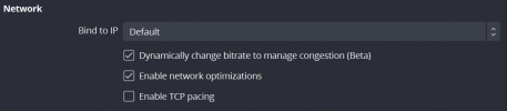

AV1 may not support Dynamic Bitrate. When AV1 is selected as the Video Encoder for Streaming, go to Settings, Advanced, Network. If Dynamic Bitrate is available and enabled, it should look like this:
If that is not available, then AV1 doesn't support it. You'll either need to lower your bitrate to the point where you're not dropping frames or use HVEC or H.264.
grepolis
Yeah, I did select "av1" AND "Dynamically change" as you can see in this screenshot. But frame drop still happen

When Dynamic Bitrate is enabled and working, it should show it in the logs such as:
14:59:52.954: [rtmp stream: 'adv_stream'] Dynamic bitrate enabled. Dropped frames begone!
Your log does not show that. Try using HVEC or H.264 with Dynamic Bitrate.
grepolis
Ooooh yes, you are right. I just tested and yes I can confirm that AV1 and HVEC still don't work with "Dynamically". I was only able to actually use it with H.264
