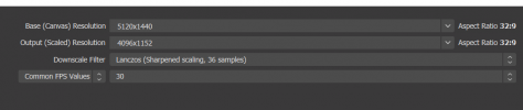

Hi folks.
I like to stream stock market related content to my Youtube Channel. As it stands, I'm currently using a 49" monitor with a 32:9 aspect ratio. For archiving purposes, I also stream in a 32:9 ratio.
However, when I stream to YouTube VS record the stream offline, the quality is vastly superior offline, despite me using the same settings. I imagine part of this is because YouTube downscales quality greatly.
With that being said, is there anything I can do to make my quality better besides just uploading at a higher Kbps. (I'm currently at 13,000 and have an upload speed limit to 20Mbps).
I've attached pictures of my current settings.
Here is the a link to the stream so you can see the quality for yourself. LINK
Thank you for your time.
PS. I don't need to record audio for the stream at all.
My processor is a Ryzen 5950x
My videocard is a RTX3090

skybits
Your output resolution should relate to the resolution your "audience" will most likely be viewing your stream on from their device. Do you think your audience is watching from a 4096x1152 screen? Only you can answer that question for yourself. My question is provided as a way to help you analyze your own situation.
Also check out this thread about the Lanczos downscale filter to decide if it is the best choice for your stream > https://obsproject.com/forum/threads/which-downscale-filter-to-use.125517/
sandrix
The problem is your monitor resolution and how your video is displayed to users with a 16:9 monitor and so on.
