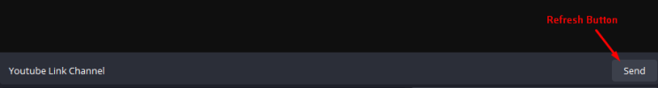

Hello, I've adapted a Python code from Youtube chat and channel updater. I made some modifications because the interval for refreshing in seconds was causing "Encoding Overload" in my OBS when streaming or recording.
To address this issue, I removed the timer update interval and implemented a hotkeys version or refresh button.
I decided to remake this code because, while streaming on YouTube, I needed a way to update my YouTube Studio live chat automatically instead of doing it manually once each time before I start streaming.
Now, I'm wondering if it's possible to dock this code in OBS. If so, how can I do it? What I mean is, can I integrate this functionality directly into OBS for easier access and control?
this is my code what i remake

i mean not that docker, but docker OBS, that you can see in your overlay obs UI
