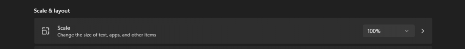

Set Monitor Scaling to 100%, it's currently 125%

these are my settings i also Set Monitor Scaling to 100%
