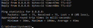

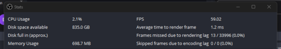

Ive been streaming for years and and just last week my streams started dropping network frames MASSIVELY. I havent been able to get one stable stream out. Ive never had this issue before, ive made sure ive updated all drivers, checked my settings in OBS, reset my modem, changed ethernet cords. I even reset my entire pc. Its still doing it. I will provide my logs, someone please help. :( all of these logs are just from tonight. I will also provide my pc specs. Im also having some redering lag. No packet loss on test.

Though... see all those streamlements (such PoS code) errors - try a test using portable mode, WITHOUT anything relate to streamelements, and try again. Why? shouldn't, but if code getting hung up on streamelements timeouts or related, causing network traffic hiccups, coudl be somethign not helping
19:16:39.187: Output 'simple_stream': Number of dropped frames due to insufficient bandwidth/connection stalls: 10583 (65.5%)
see FAQ on this site related to dropped frames
Other than that, other activity on your PC can interfere (stuff you are unaware of, and malware), other traffic (both that which you expect, and that which you don't) on LAN can cause bottleneck, and then in really rare cases, something at ISP, or your own WAN link... but this list is in the order of probablity.

In response to the stream elements, I had my boyfriend run a test on his PC with a different OBS and twitch account with just game capture and nothing else and it did the same thing to him today. I’m almost positive it’s my ISP. We tried calling them last night, but they didn’t really help out much. Just told us to reset our router basic stuff that I already tried.
I would understand the bottleneck if it was just one stream, but I’ve tried to go live with tests and real streams at least 50 times in the past week and every single stream was having network lag. Ive streamed on the same Internet service provider for a few months now , I just moved a couple months ago, but I didn’t start having this issue until last week.
