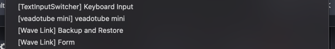

I use a hub to connect all my devices (capture card, microphone, streamdeck), and I stream from a MacBook - so when I disconnect the hub and reconnect it, OBS never remembers my capture card, and I always have to refresh it...
Is there a way to make sure I can disconnect the hub, reconnect it and not have to do this every time?!

I'll explain it maybe better this time. I have to reselect my device from the properties menu each time I connect the USB, and the same issue goes for using Veadotube, where I need to select the window I want it to capture. I started using Advanced Scene Switcher, and it has the option to select these things when a certain state is present, you can ask it to get current settings, which is a random string of numbers, but again after you unplug the UBS and plug it back in, that string also seems to change, so I can't even use this to automate it...
Send help!
the photos provided show the greyed out version of the capture card previously selected, I have to reset to default for it to refresh the list, to allow me to select it again - and within the list of Veaodtube, it auto selects something from the list, and doesn't ever remember I want veadotude selected.

I found a solution that works, and it might work for you.
I've been using the source 'video capture device' - I have an external capture card, so I thought that would be the one to use. I've changed to using 'capture card device', now it remembers the capture card, and no need to re-select it each time.
I hope this helps you
