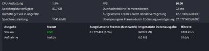

VicePrey
Those are the stats that i have while streaming and playing mc e.g. I guess that isn't so bad because it's zero percent everywhere and nothing goes red.
