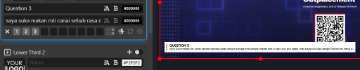

Hi. Thanks for developing this wonderful tool. First of all, I am not really a coder. I will use this lower thirds for Q&A session, but can I expand the info field to more than 1 line?
