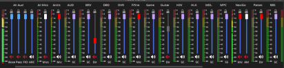

I use Audio monitor for a lot of audio managing on my PC, and was wondering if a hotkey could be added to restart all outputs at once, instead of having to manually mute and unmute outputs, or my current method of just restarting OBS, which restarts everything at once​
...restart all outputs at once, instead of having to manually mute and unmute...​
If you're fixing the runaway latency problem, a better solution would be to send each of your physical outputs to a virtual device first, and then from that virtual device to the physical one. Move the problem from OBS to somewhere else, where it *is* handled correctly.
The problem has to do with clock drift. If the CPU and the sound card use the same physical clock, everything's fine. But if the sound card uses its own clock, they drift out of sync even for the same nominal sample rate. That causes buffer overruns or underruns, depending on which direction the drift is, and both cause OBS to increase the size of the buffer as if it were a network stream. Wrong response for a physical thing!
A virtual device uses the CPU clock, so it doesn't trigger OBS's bug, and has its own separate opportunity to handle the physical sound card correctly, which it usually does.
