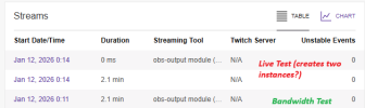

I'm trying to set up Twitch's Enhanced broadcasting mode in OBS. I've tried testing the setup by turning on "Enable Bandwidth Test Mode" and via the Twitch Inspector; it detects and runs fine without any issue.
However, when I turn off the test mode, both the Twitch Inspector and my Twitch Dashboard still detect as Offline. The weird thing is that in the Inspector, it still detects my "live" stream, but reports no data...
Ive attached all I could think of to show my findings, but feel free to request anything else from me and I'll get it to you ASAP.

Okay a quick update here:
Still no luck on my end with the EB settings working normally, however, I decided to do a test by setting up a new profile and using an old alt account I had (for stream testing back when Inspector wasnt a thing and OBS didnt have a stream test feature)
Lo and behold, it worked without issue! I then signed out and into my main acoount (using the test profile) and still no ability to livestream with EB enabled...
I switched to my main profile, signed out and then logged in as my alt account, turned on EB: worked like a charm! Switched back to my main twitch account; issue stil persists when EB is enabled.
At this stage I think its a Twitch-side auth/ingest server problem so I've reached out to Support to see if they can help once more; though im not hopeful.
I'll get an OBS log in the next day or two using the test profile and test account for anyone to look at and see if they see any issues on my end but as I said: i dont think its a user/software/hardware/network issue from my side of things at this point in time.
