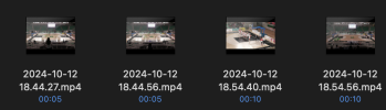

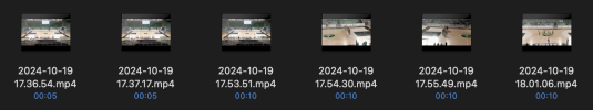

Two problems
- when I start to save clips, a few minutes the new clips are slowdown. It´s only in the image, the sound goes in normal speed.
- In the OBS' new version 30.2.3, the program crashed when deletes the Replay Source.

R_Bob
Two problems
I found the first problem, it happen when the streaming have a different resolution than the program's resolution.
