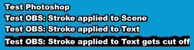

I'm not sure how much of this is under your control Finite but the best Stroke method for Text (GDI+) also cuts off the Stroke.
For this example I turned off anti-aliasing for both the text and the stroke (including the Photoshop example). The problem is compounded after anti-aliasing so I'm trying to get to the source.
Notice in the bottom example, when you just apply the Stroke to the Text (GDI+), it gets cut off. The only solution I've found is to nest the Text (GDI+) inside a Scene and apply the Stroke to the Scene. The problem here is that the Stroke renders differently (and worse) as you can see in the middle two examples. You can see when the Stroke is applied to the Text (GDI+) source, it renders better rounded corners noticeably on the T, :, k, li, and d versus the blocky corners when applied to the Scene. So you have to trade off between cut off edges and better Stroke rounding or the full Stroke but at a worse render.
Also, the Stroke Size is very different when applied to the Text versus the Scene. It was something like 4-7 on the Text but on the Scene it had to be around 25 to match what's shown in my example.
Lastly, and this is the part that may be out of your control, even the best options don't render as well as Photoshop. It's hard to tell if it's the Stroke itself or the differences in OBS and Photoshop's rendering of the font before it even gets to the Stroke. The comparison for this would be the 1st and 3rd examples, ignoring the cut off edges of the 3rd.

Hi TMBGeeks-
Thank you for the feedback on the stroke plugin. Comments inline...
The good news is that you can fix the stroke being cut off. Essentially what is happening- text (and all sources) have a bounding box, that when we pass through a filter, will cut off anything outside the bounding box (the bounding box can be visualized by the blue border around the source when your mouse hovers over it in the sources list). I only recently learned that I can have my filters expand that bounding box, and so I am working on an "auto-padding" checkbox that will do just this. In the meantime there are 2 different workarounds:
  1. For text sources specifically, there is a "Use Custom Text Extents" checkbox that when checked lets you specify the size of the bounding box. If you set it larger than the text + stroke, and set the Alignment and Vertical Alignment to center, you should be able to avoid the cropping of the stroke.
  2. An easier way (as it works for all sources, doesn't require you to change the text alignment, and will resize automatically if your text changes) is to use the crop/pad filter (built into OBS) in the filter chain *before* the stroke filter, and give it negative padding:
Additionally- for text sources in particular, if you need a 20px or smaller stroke, I'd recommend using the text source's outline option instead, as it will render a better quality stroke for reasons I'll explain further down.
That sounds like a bug, and I'll look into it. I have a feeling it has to do with how I layer/render the effects- I found some flaws in how I was doing things, and fixed them in my other plugins, but due to a few difficulties in the code, I haven't yet been able to implement the new rendering pipeline for Stroke/Glow/Shadow. I'm about to release 2 new plugins, and once those are done, I'll be putting some time into fixing some of the bugs in this plugin.
Some of this might be due to the rendering bug I mention above- it renders some things strange with alpha blending, which makes the edges on things like text look a bit funny. I'm hopeful that this will be fixed in the next release.
The point about how it renders differently than Photoshop (and from the text source's built-in outline) is absolutely true. When photoshop (and for that matter the GDI text source) renders text, it has (or builds) a mathematical description of where the edges of the text are. If you're familiar with graphics terminology, it is like using a vector format, that describes the shapes on the canvas, which lets them be resized without any loss. It also lets you mathematically describe what the stroke should be around the text.
Unfortunately, by the time the text gets to the stroke/glow/shadow filter, it has been rasterized, so now it is more like working with a jpeg or png- I dont have access to the description of how the text shape was made- I only have the resulting pixels. The way the plugin works is to use a fuzzy circular sampling to see what neighboring pixel alpha values are, and construct the stroke, glow, or shadow from that. This means that for complex shapes like text, inside corners especially will become a bit "thicker" or more blobby than a perfect stroke.
I hope this was all helpful. Please let me know if you have any other questions.
Cheers!
Thanks for the detailed reply, that explains just what I wanted to know. I'll play around with the padding and I guess we can only do so well with a stroke until someone is able to incorporate vector fonts into OBS which may not be possible. Keep it up, looking forward to future versions.
