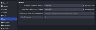

Jacon
Also some of my OBS setting rn

You need to reduce load, plain & simple. Run your monitor @ 60 or 120HZ. Reduce game quality, cap frame-rates, remove java script errors, ect.
OBS was @ 44k in the first 3 logs. Fixed in last log but the log ends when you started recording.
