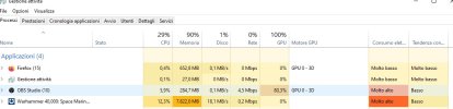

I don't want to completely destroy the game to stream because OBS use all the GPU or whatever. It can't be that way only.
  • 2024-09-16 16-27-34.txt

I'm not familiar with that game but it is clearly stressing out your system.
Your system is really thin on RAM, virtual memory may be thrashing.....

The fact is that I have to adjust OBS so that it doesn't "consume" too much but maintains good quality.
If I have to put everything to minimum to stream one game the problem could recur for another. Also I can run it with ultra setting with no issue. Without OBS.
I understand that for streaming I have to lower some parameters, but I can't and don't want to put everything to the minimum, cam and stream included. People with lower hardware can strem it with no issue.
It cannot and must not work like this.
Only way to fix the RAM I imagine it's to improve the harware?! Or there's some wizardry?
